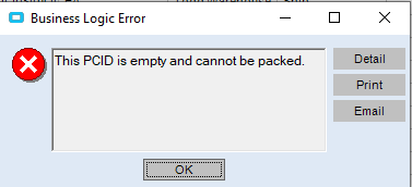

Thanks @Chad_Smith. Something else is askew here. I tried that and I get this:
Part was in a PCID, and has since been unpicked/removed from the PCID. The PCID is indeed EMPTY but this record still exists with the PCID data in it. :frowning:
This got me to the solution. I had to do a bit extra because we use PCID. I had to re-reserve and release, then pick the line into the same PCID that was referenced before. After that I could create the pack from Picked Orders and delete it like you suggested.
