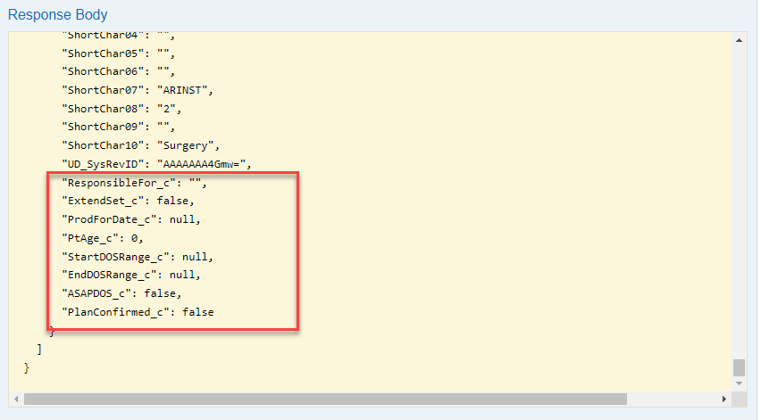

I’m a little confused, are you saying you do not see your custom UD field in the schema via REST?
In the swagger page, you should see your fields there and if not you might need to regen your data model.
They will just be the field name as it appears in your table.
Yes … I’m not seeing them … and I already did a regen of the data model. Turns out that was because the added field isn’t appearing at the end of the list in the swagger:
So … I guess it was there all along. Is there a way to put all the new fields at the end of the listing?
