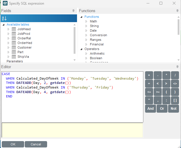

I am trying to write a query in which I set a date filter based on the results of a calculated field within a BAQ. I’ve got a BAQ in which I am returning the current day of the week. If the day of the week is a Monday, Tuesday, or Wednesday when my BAQ runs, I need to add 2 days to the current date for my date filter in the BAQ. If the current day of the week is Thursday or Friday, I need to add 4 days to the current date for my date filter.

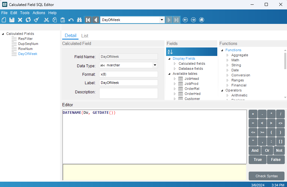

I’ve got the SQL to return the current day of the week in a column, is it possible to reference a calculated field within the filter value of a BAQ? This is looks like a valid case statement, but when I run the query, these are my errors
Excuse my ignorance, but is that a setting within the BAQ designer to expose those fields?

(DATENAME(DW, GETDATE())) as [Calculated_DayOfWeek]

where (JobHead.Plant = @CurrentPlant and JobHead.JobReleased = 1 and JobHead.JobClosed = 0 and JobHead.JobComplete = 0 and JobHead.ReqDueDate = (CASE
WHEN Calculated_DayOfWeek IN ('Monday', 'Tuesday', 'Wednesday')
THEN DATEADD(Day, 2, getdate())
WHEN Calculated_DayOfWeek IN ('Thursday', 'Friday')
THEN DATEADD(Day, 4, getdate())
END) and JobHead.Shift_c = @Shift)
Oh there it is, that should be fine.
Since you are doing this in one top level query, you might need to perform the calculation as part of the where clause, since when this runs it hasn’t created the calculated field yet. You wrap the entire query in a subquery, then select all from the subquery and apply your constraints with the calculated fields there too
