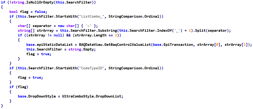

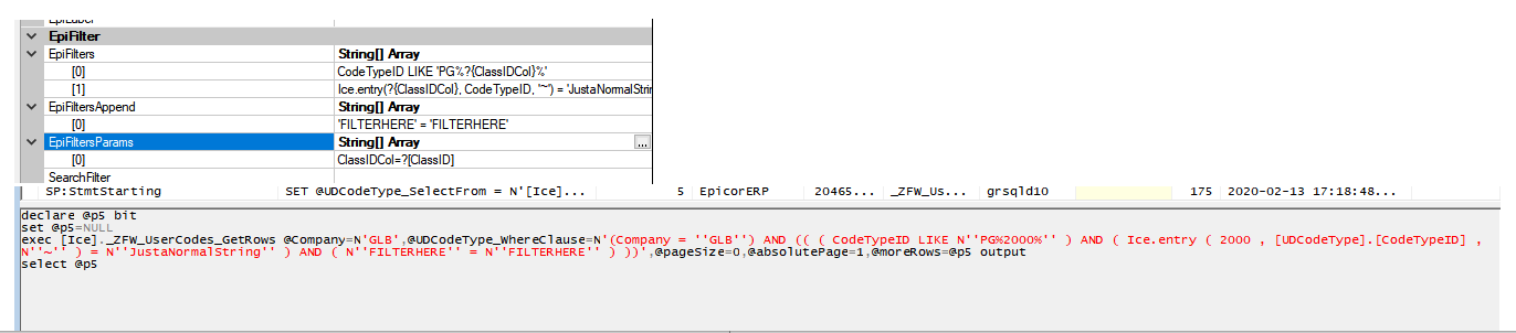

I usually use Epicor settings on a combo to handle the Refresh.
