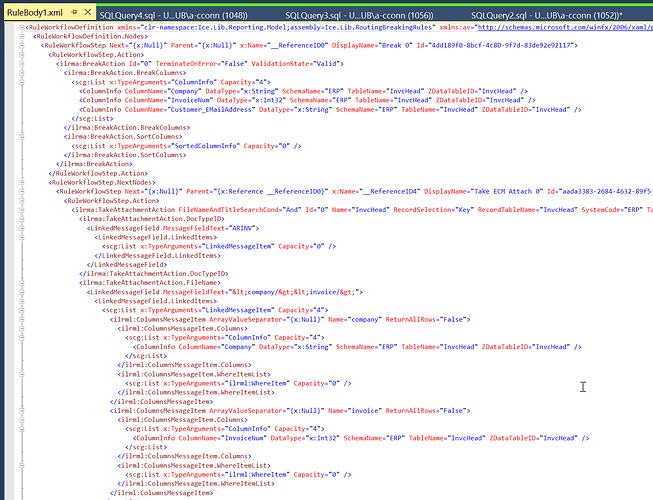

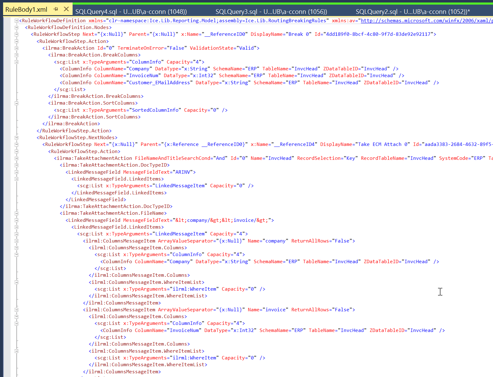

Dont tempt me with a good time
hahaha nice man
You need to update the RDD with the new fields, make sure you add teh SysRowID field or none of your UD fields will come along. if you create a new RDD, routing rules cannot (last I looked) change the RDD assigned.
I think someone edited the routing rule RDD in SQL once. Not me, I wouldn’t do that.
