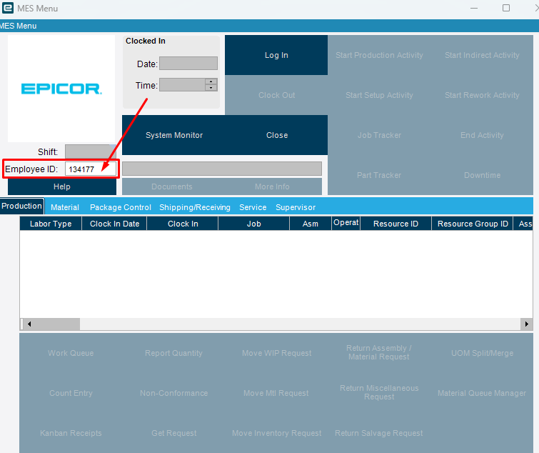

I am performing a BPM to obtain the Employee Id into MES, but I cannot find a way to obtain it.
I am using this.call Context Client.CurrentUser but this brings me information about the user who connects and not the Employee ID since that computer is used by several users and I need to know the person who captures
