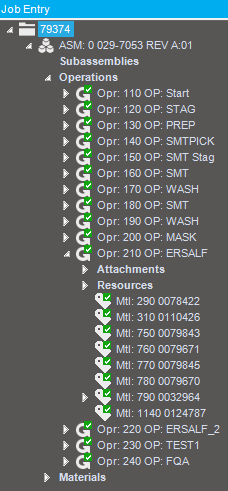

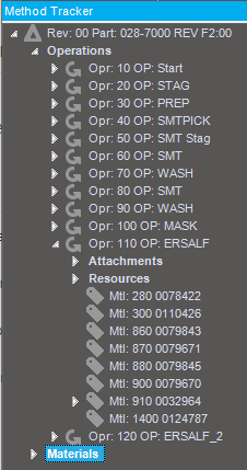

Based on something one of our engineers said about his previous system I had to test this out. If you have a phantom method and assign the material to the operations like a regular method would have, you can leave out the last step like inspection or pack-out. When the phantom is brought into the higher level assembly, the method will add the phantom ops and materials first, then the parent ones. I guess some people will have a business need to operate this way. One of our companies does.
Parent:
Phantom:
Job for Parent:
