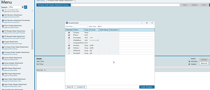

I want to remove attachment in the PO because we are moving our ECM to the cloud. I believe all of our on prem ECM links are obsoleted.
Has anyone delete these links in bulk? If yes, how did you do it?
I know that the two tables that I need to remove entries from are Ice.XFileAttch and Ice.XFileRef.
If the db and the files move the same links will work they will just have a different server in the config.
If you can Query the right data from those tables and build the dataset, DMT will allow you to remove them in bulk. (I’d add xfilerefnum and doctypeid to the required fields list.)
We are still on-prem but when we implemented ECM I wrote some migration scripts that extracted the documents form the file store, then re-imported into ECM and then lastly used DMT to purge the old documents.
Using the BO’s to do this meant that the old file store got cleared out at the same time. I guess if you are not interested in retaining old documents then as previously suggested you can just use DMT and then delete the file store afterwards.
