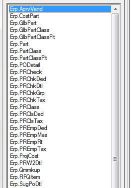

And While I wish you the best of luck, I don’t think you’ll be able to delete a PartClass once it has been used. ClassID is a field in the following tables:
image image
