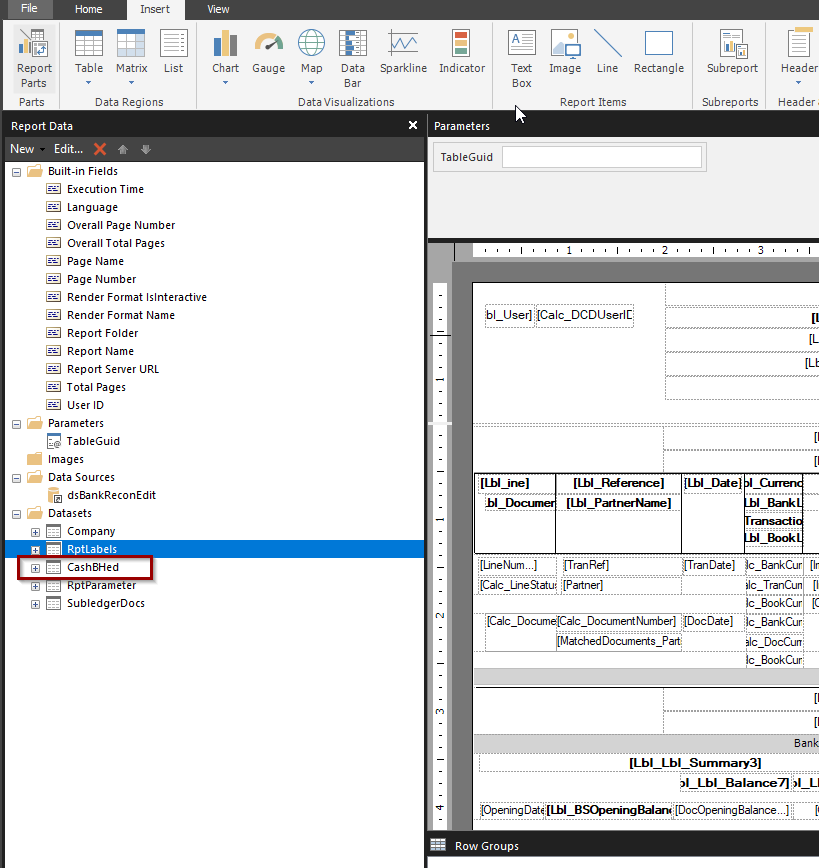

In report Builder, I am trying to add a field from a table that is not listed (CashBDtl). Where would you actually go to add new fields/tables?
I am just modifying the delivered BankReconEdit report and making a custom file, and want to include the CashBDtl.UserReference field. Only the CashBHed record is available in report builder.

Thanks Utah - That helped. I do see the table/field in report definition and its tied to the correct Report style.
Its just in report builder , I only see the CashBHed table.

so now look at the dataset in the report builer.
Study the query closely.
You will see that it joins all or some of those tables together.
What you will need to do is determine how the cashbdtl table fits into your query and adjust it accordingly.
You may also wish to create a new dataset and write your own query depending on your intentions.
