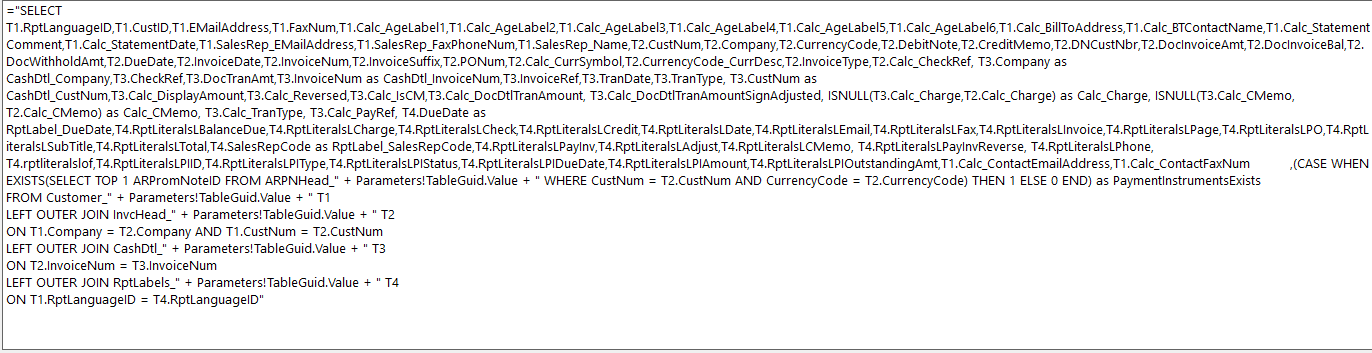

Here is the query I’m running:
I’m just at a loss on what to try next.
What edits to the Select statement in your screen shot did you add to bring in the new fields you want to display?
Here is the original:

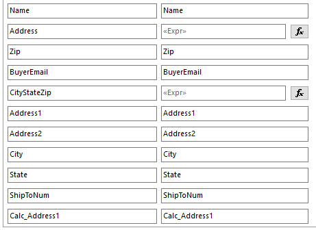

Did you add the fields to the Report file?
I did:

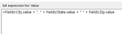

And I attempted to concatenate some of them and it only shows the “,” on the report UI because it’s not pulling the db information.

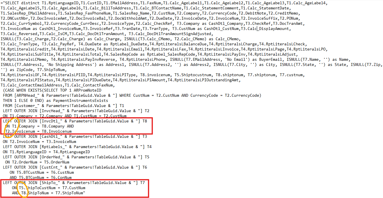

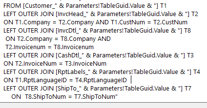

I’m not sure if this is possible or not… I think I’ve tried it but with mixed results… but you’re joining a couple of your tables by linking them to multiple other tables.
From the RDD perspective, your relationships can only join tables 1-to-1. And RDL query should match whatever relationships you created in your RDD.
The first one should be an easy fix, just change T1.Company to T2.Company.
But the bottom join may be causing you fits.
That was my first thought. The other thing would be to confirm the joins in the RDD are correct.
Thank you! I’ve changed this so many times to try to get it to work, I missed those when I was going back. Even changing the bottom to simplify the joins and taking out tables that are not directly called, it fails to provide address information.
The joins in the RDD mirror the environment and the SQL joins listed.

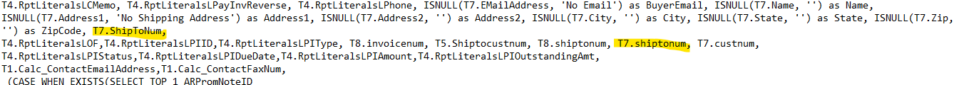

You query uses
But your field is declared as:
I have ZipCode as well, above the Name. I threw both in there to be sure it was covered since it wasn’t populating.
Maybe break your address expression into individual fields and see if ANY of them come through individually.
Or even delete all of your fields and add them back one at a time. See if you can get SOMETHING to pass through.
Also saw you have T7.ShipToNum called out twice:

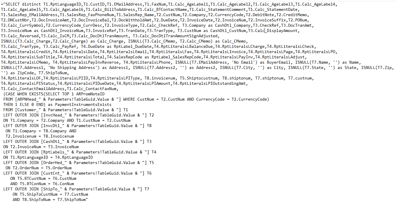

Can you paste your query text in here (not a screen shot)?
="SELECT distinct T1.RptLanguageID,T1.CustID,T1.EMailAddress,T1.FaxNum,T1.Calc_AgeLabel1,T1.Calc_AgeLabel2,T1.Calc_AgeLabel3,T1.Calc_AgeLabel4,
