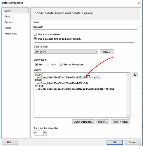

Interesting, I’ve tried the code and I’m getting an error.
SELECT
ActLabCost
FROM
JobOper_” + Parameters!TableGuid.Value + "
WHERE
SubContract = N’False’
Incorrect syntax near ‘”’.
Unclosed quotation mark after the character string ’
WHERE
SubContract = N’False’’.
Query execution failed for dataset ‘DataSet1’. (rsErrorExecutingCommand)
An error has occurred during report processing. (rsProcessingAborted)

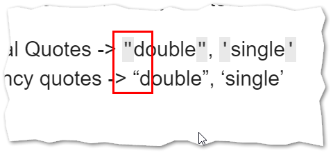

First off, be careful when copying code from posts. If the person that posted it didn’t use the formatting syntax, single and double quotes are replaced with “fancy quotes”
real Quotes -> "double", 'single'
fancy quotes -> “double”, ‘single’
See the difference:
Code in E10 can’t use the Fancy quotes.

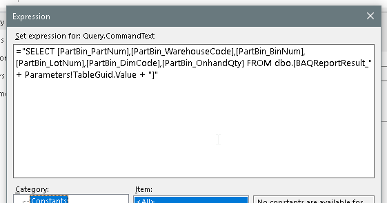

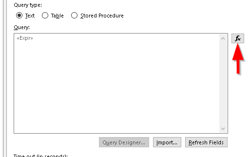

Since the query is actually an expression, the window will look like:
Clicking the [fx] button (arrowed above), brings up the expression editor:
this is where your expression needs to be.

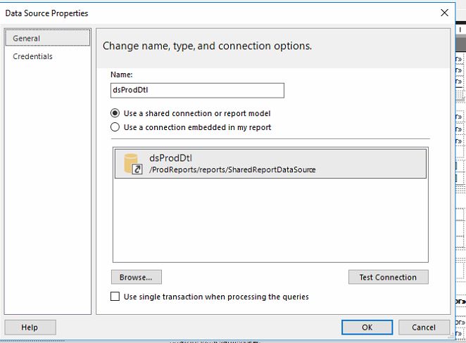

And one last thing, you do have a datasource setup?
Yep, I do have a DataSource for the report. I can run the report if I take out the query for the Labor Cost.
