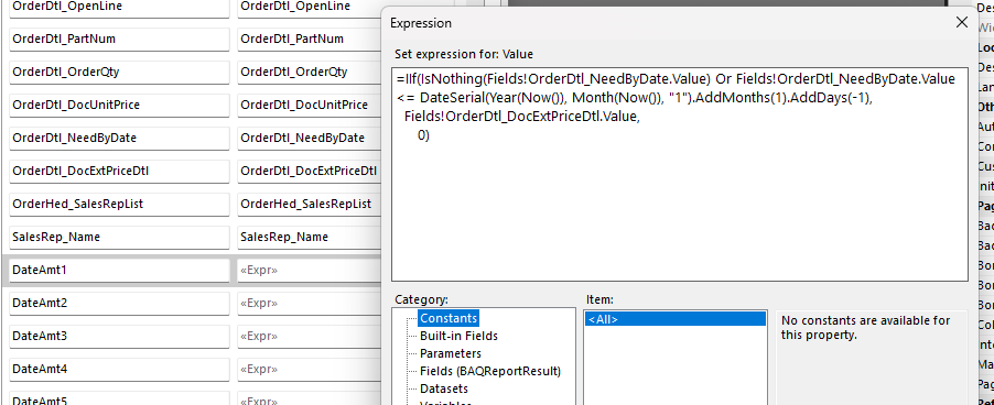

You do not have anything in your expression to handle NULL dates.
Try this.
Iif((IsNothing(Fields!OrderDtl_NeedByDate.Value)) OR (Fields!OrderDtl_NeedByDate.Value > DateSerial(Year(Now()), Month(Now()), "1").AddMonths(1).AddDays(-1)), 0, Fields!OrderDtl_DocExtPriceDtl.Value)
Thanks @jkane, but I’m still encountering the error.

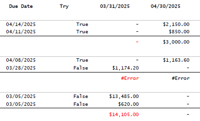

Sum(DocAmt1)
Still having error Output

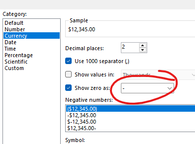

Why are you showing the 0 values as lines? I’m wondering if that may be it.
you mean sir this
Even with it unchecked, I’m still encountering the issue.
Something that can narrow down the offending issue is to temporarily drop an un-aggregated table including all of the values in that field on the report. If other fields are necessary to drill into a specific record, include those too. Add a field to the table that’s doing the math you want to do, scoped to each row.
If some but not all rows return an error, you have more detail about the cause. If all rows universally return the error, there’s something going on with datatypes or the math or something else in general.
Thank you, @jkane , I got it now.
I moved the Calculation field to the BAQ instead of the Report Builder, and everything is good now.
