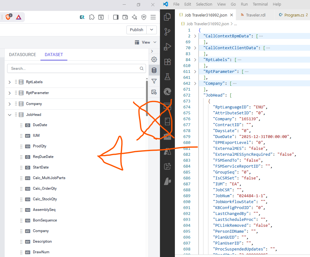

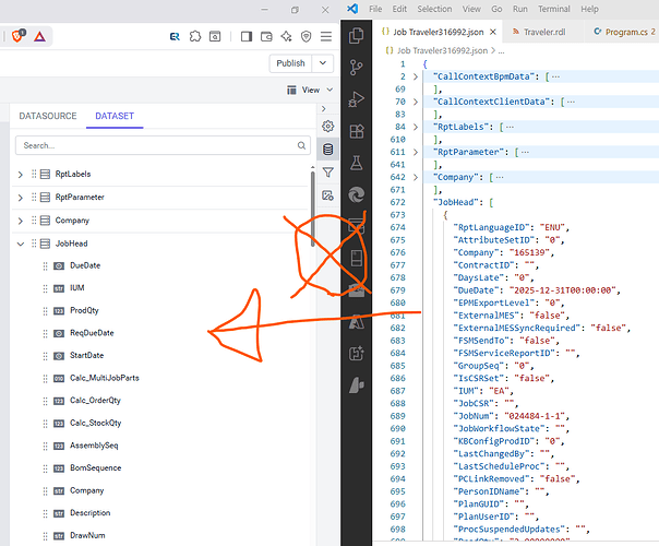

Thanks for your reply. I read your threads. Lemme restate:
There’s no way to get data from api after ReportSvc\SubmitToAgent or \SubmitDirect aside from finagling the RDL to render text in output bytes.
Which is cool by the way, but involves mod’ing styles/RDLs for all my reports, AFAIK.
Just want the data of any submitted report, base or custom. Perferably in json format like the ds{Table[],Table[]} in the rdl but I’d settle for anything outside of RDL mod’ing.
Temp tables are somewhere after submit but not accessbile outside RDL so I can stop researching your awesome threads and stop trying to avoid RDL. Am I right?

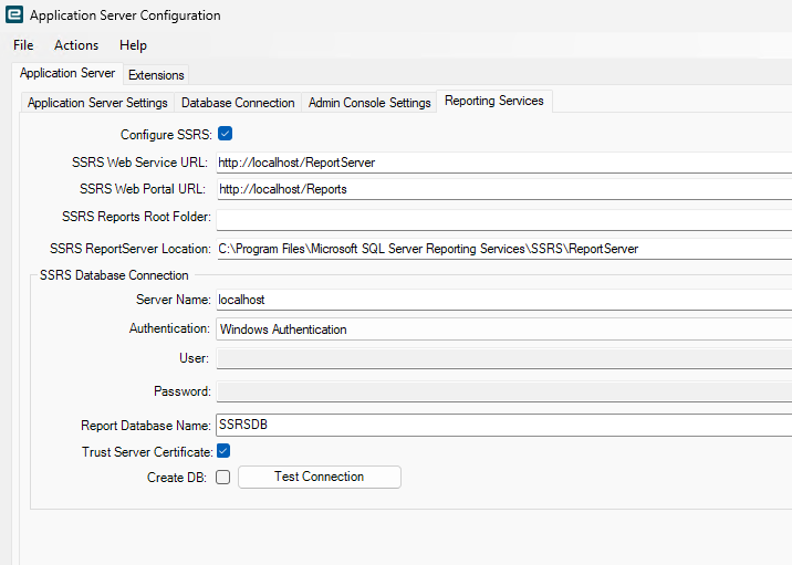

Somewhere in there is also an error about bad SQL username/pw, but my case on epiccare is so long it lags my browser out. I need a faster computer to search it! (side note, i wish epicor would fix our ssrs issues)
In the Application Server configuration for SSRS, on-prem people see:
AFAIK, the only two authentication methods are Windows Auth and SQL Auth. Entra is possible in later versions but not in Kinetic. I think I entered an Idea for it. If the automation software Epicor uses to maintain the creds is broken, I can see how you’d get those auth errors zipping by.
I’ve have not tried it in a while but if you are just looking to do this for testing I believe it is still possible to switch the report style output location to XML instead of database. Then if you run Your report in generate only I believe you can get the xml of the data of the RDD from the reports location under the Epicor data directory (server file download)

Easy trick is to change the Output to XML then use server file download to get the XML file to examine.
Thanks gentlemen.
Might worth a look to avoid RDL.
I wonder where it goes for cloud tried:
Server File Download
\Reports
\Company\Processes\username
\Company\Temp\Username
\user\temp
\admin\whatever\whatever
It works from System MOntor. Oh well. I’ll keep trying things. Thanks again.
These are good questions, Josh. I don’t think Epicor knows exactly how the integration will go yet. I’m sure they have some ideas otherwise they wouldn’t have cut the deal. If I were a betting person, I’m thinking there might be a REST interface. But, who knows? :person_shrugging:
Turns out the XML output is some sort of rendered report transformation. Not an XML version of the standard ds{Table[],Table[]} I was hoping for. Thanks again. Take Care.
Where did you change to xml?
It needs to be in report style maintenance. Not the report submission app.
If done on the latter then yes it is SSRS that is still driving that.
Ah I see now. Yeah that output looks like RDD def plus data. This could actually work. Thanks Ben. Thanks all.
PS- Must dig back into @klincecum s posts about ServerFileDownload. Postman doesn’t find the path when using same request as browser. Thanks again.
Update: So this was a series of many dead ends.
Was hoping maybe Bold Reports treated XML/JSON as queryables but it simply imports and flattens nested file sources.
Even if we middleware-pulled and separated the source into individual files by table, querying joins like inside RDL would still require a relational engine.
Hooking up to SQL Azure just for the engine and doing OPENJSON might work but that involves a middleware also doing signficant, fragile transformation of already poor dynamic SQL expressions in Epicor RDLs.
Basically no way to get from here to there:
My guess is they’ll just open up the Reportsdb as a shared connection and keep eveything as-is.
Anyway, it was a learning experience. Back to MSReportBuilder. For now.
