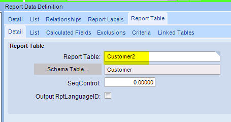

I was going to suggest adding the 2nd table with a different name, like:
But that also yields an error when trying to save.
You’d probably have to create view of the table you want to add, then add the view. If that’s even possible.
