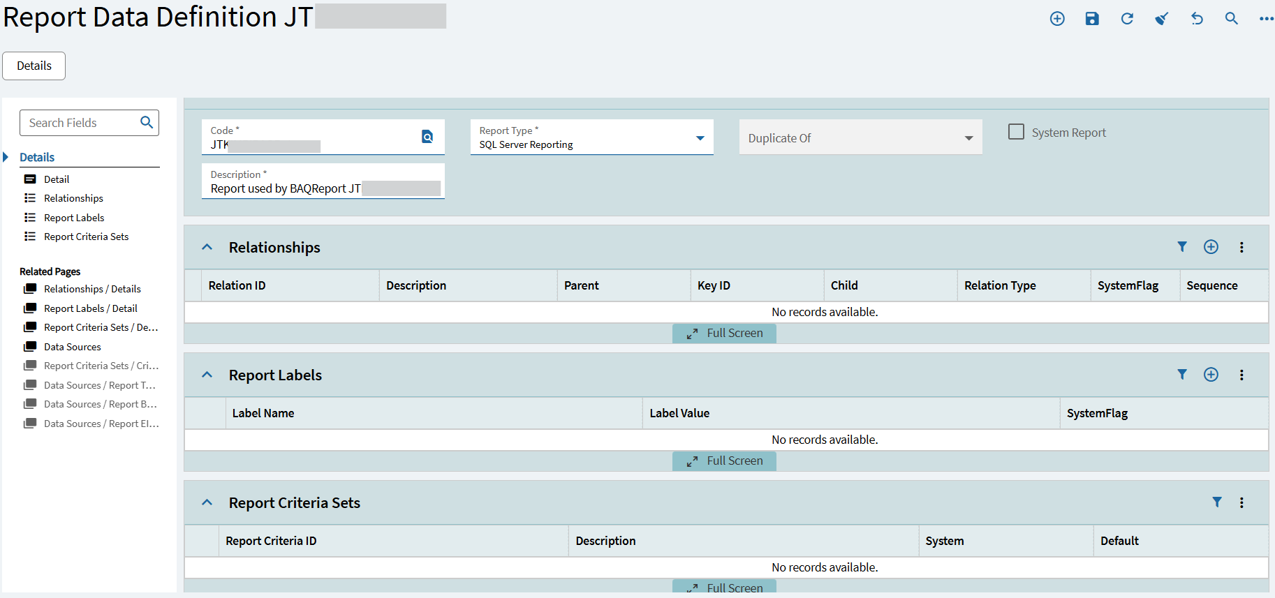

When I create a BAQ and then setup the report through BAQ Report Designer, it automatically creates a style and data definition for the report. My question is, why is the RDD not consistent with the components in Report Builder?

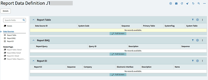

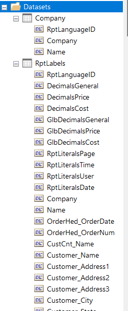

For example, here is the RDD that was automatically generated by BAQ Report Designer that shows Report Labels are empty.

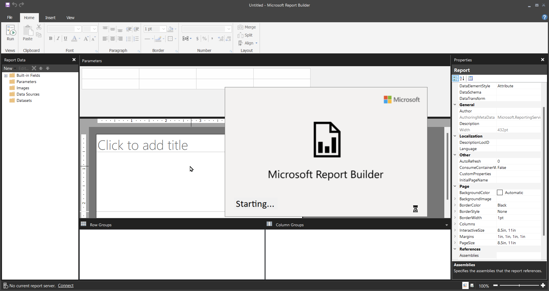

But then in Report Builder, there are RptLabels.
Also in Data Sources Report BAQ is empty. So where is the link to the BAQ defined?

Think of the RDD as the dataset to send to the report db to query on and it is created against a specific GUID at run time thus creating your dataset with the appeneded GUID code. When you update an RDD you add/edit/remove columns from the data table(s) within the tables to be sent to the report db. You need to update the RDL (report) with the changes you made manually as it will know nothing of where to place the table column data within your report even if you do not have it shown. It might be a hidden item to group or sort by. The RDL will not know what to do if you do not update the datasets and fields(columns) in a given dataset as these are not translated automatically. Hope that helps explain somewhat.

This is for any change to any RDD (Report Data Definition) and if you change the RDD the RDL will no longer match. To update the RDL you would use Report Builder.
The BAQ style allows you to bring in multiple BAQ’s versus multiple linked tables in the standard base RDD’s. Normally the base RDD will use the existing table relationships to provide linked fields available where in a BAQ RDD you would need to define any relationships between them and create the SQL to pull in the datasets in the RDL (Report). Also, it would only work against a single BAQ Dataset instead of multiples ones, but you can gain that functionality by manually editing the RDL.
I’m almost positive there are examples which talk about updating RDL’s on the forum here in Kinetic, but AFAIK Kinetic still uses SSRS reports and Microsoft’s Report Builder would be the go-to tool of choice to edit these RDL files after modifying an RDD.
The system uses the same method for both. An RDD to build a dataset to send to the Report DB to generate a Report from an RDL (Report Definition Language) file.
