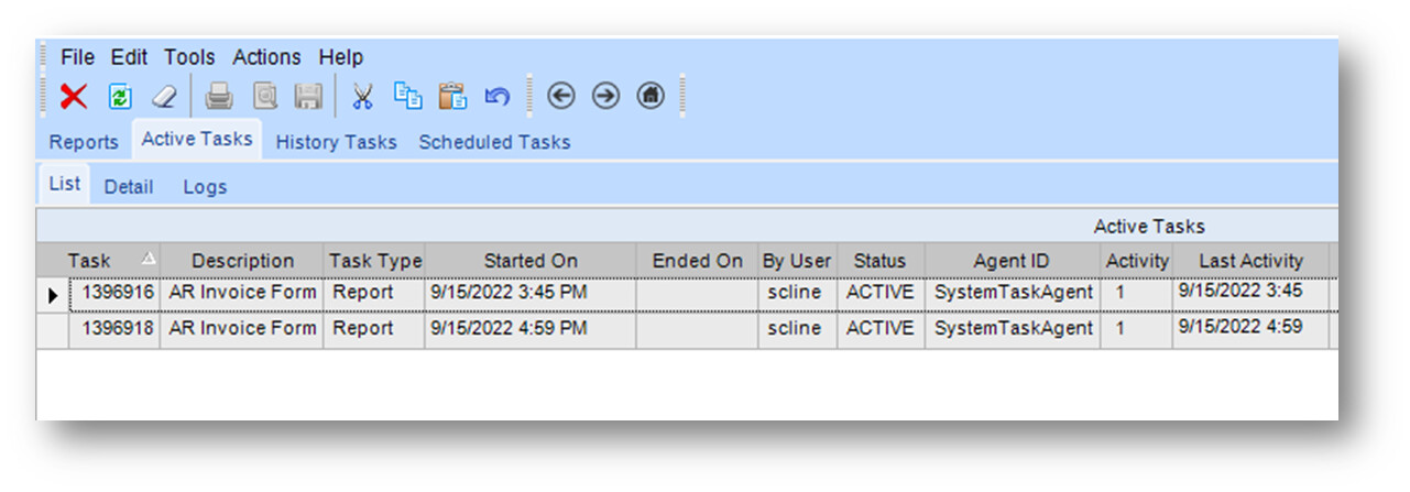

Does anyone know what other logs I could check to see what is going on? The 2 reports below have been running since yesterday and would normally take just a few seconds to popup.

I’m not confident that deleting the active task via a data fix or other means would resolve my issue since I am able to run other reports just fine while this specific report is stuck. Also, I pulled up a different invoice/CM and tried to preview that one and it got stuck also. (That’s what the 2 are in my screenshot.)
So even if Support provided a data fix to delete the stuck tasks/reports, I would think I could then run the Credit Memo report again and it would get stuck again, wouldn’t you think?
