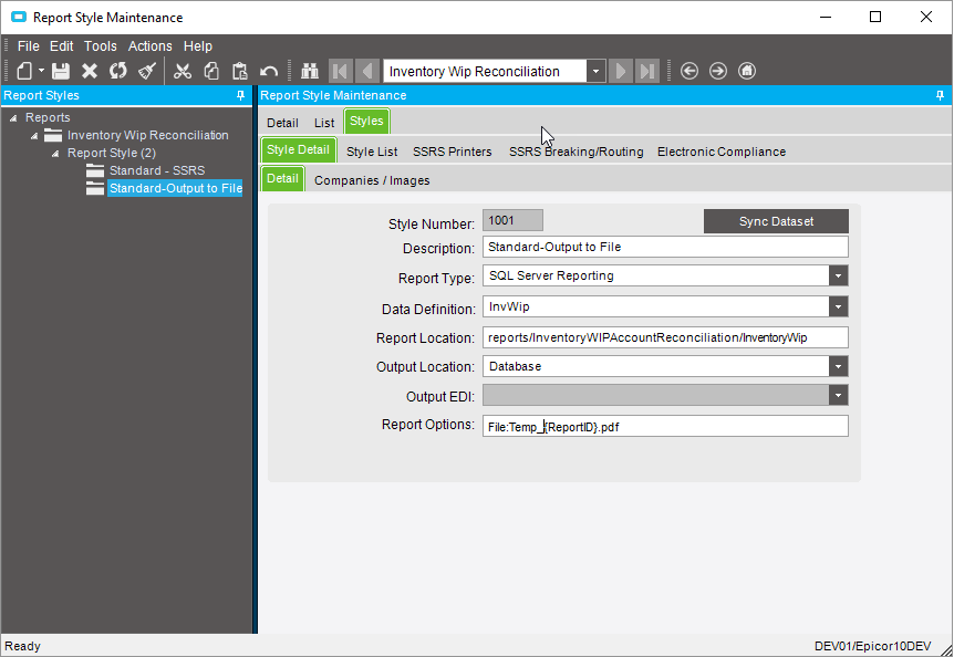

I’d like to generate a report to a file location other than the default location.
The post below goes into detail about how to use this functionality, although I am having trouble getting it to write anywhere besides the default \EpicorData\Reports{user}\ folder.
I am able to specify the “File:” option and name the report with the parameters available
But, if I specify a different share, it fails to write the file.
In the example below, I create a file share ("\file01\Debug") and make sure that the app pool identity where the task agent is running has full permissions on that share.
It throws the error when I try to run that report:
Program Ice.Services.Lib.RunTask raised an unexpected exception with the following message: RunTask: Unauthorized server path "\\file01\Debug\{ReportID}.pdf".
Is there some trick to getting this to work properly?

What’s weird is that the share is given full permissions to all my service accounts. No reason I can think of why it’s failing, other than maybe syntax.
Regarding the copy script, that was my other plan. I wanted to chain these transactions together in a BPM but the crappy part is that I’m not sure when the file would generated, so I can’t run the script in a single transaction/schedule.
The other thing I tried was setting the ReportStyle row properties in the BPM but that was ignored outright. Probably just gets rather than sets.
