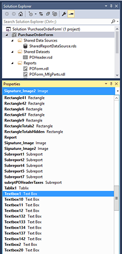

Can you tell me is there an easy way to find a text by name in the report builder? Like text1?
I wish.
If you select an object in the design area, its properties are shown (including the name).
But if you get an error like “Bad expression in txtSomeDumbBox”, there is no easy way to find that object in the design area, or select it from a list of objects. I miss this latter feature that was in Crystal Reports.

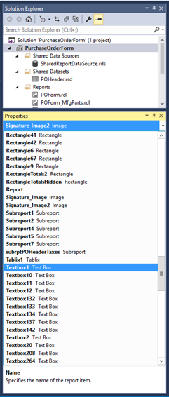

I’m still a newbie to SSRS Reports but if you work with the report in Visual Studio (which I HIGHLY recommend!) you can click under the “Properties” box header and it will bring up a listing of all of the objects within the report (Text Boxes, Rectangles, Images, Subreports, etc.):
Then you can click on one and it will highlight (with teeny-tiny little white boxes…heh. :roll_eyes:) the object in the design area and you can see where it is located.
