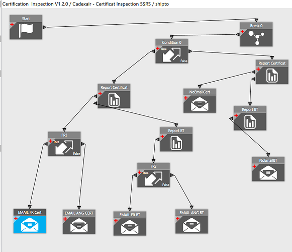

I created a routing that I need to send 2 types of report by email. One is a certificate and the other is a work order. Both report styles are active and functionnal on their own.
Since I can’t add 2 branch to a condition (example, if true, 2 actions), and I can’t add an action after an email, I tried to generate the first report that have it’s own branch and from this widget, sent a request for the alternate report with it’s own branch.
However, the “Report BT” alternate report is not generated and no email is sent for this one, only the original Certificate report.

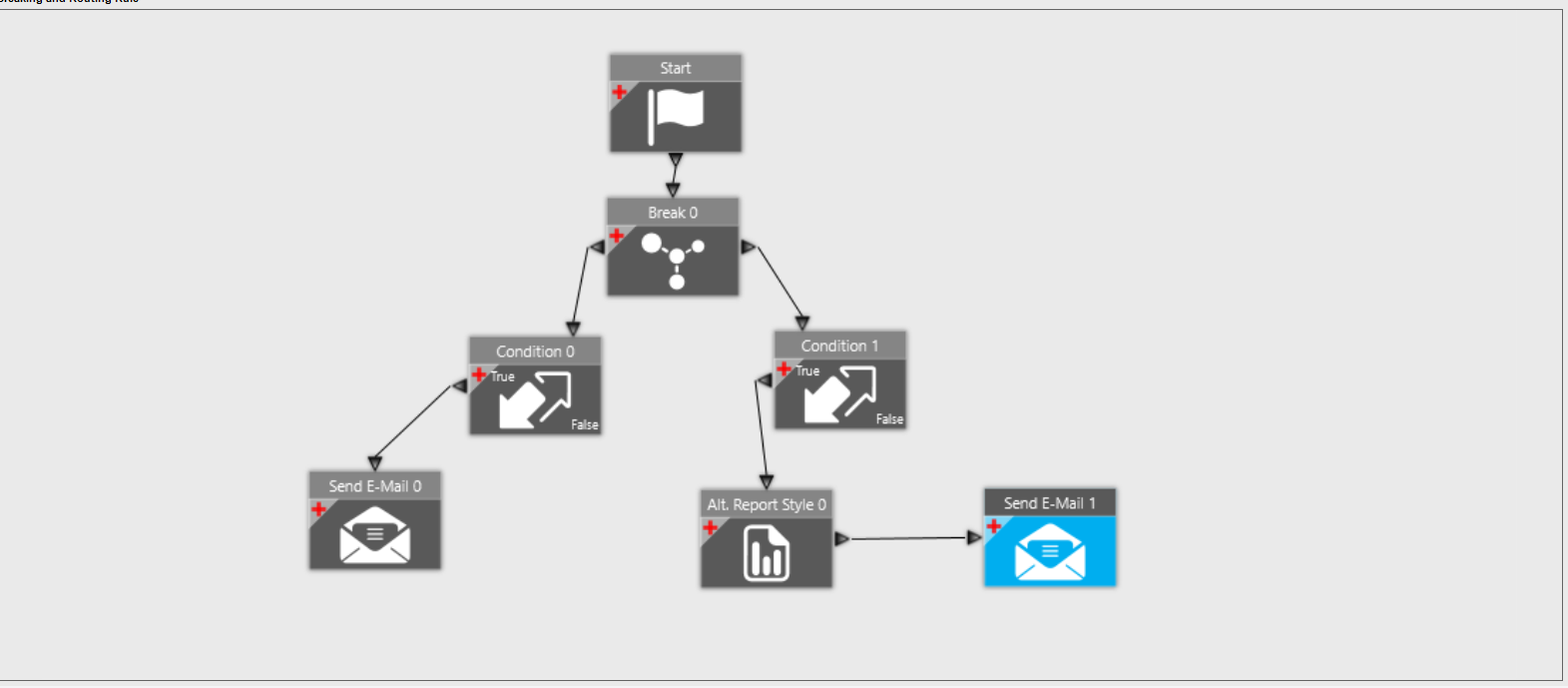

I was successful in delivering two separate emails using this routing. The Conditions used are identical and it delivered the two separate emails with distinct attachments. I hope this is what you are trying to accomplish or at least gives you path to explore.
I hoped this would work, but only the left branch will work, the other causes an error which says :
System.Data.SqlClient.SqlException: Invalid object name ‘JobHead_bee8484a238c4f54a15115c67683a605’ refering as well to the dataset ShipHeadShipDtl.
The “BT” report works independently under the same Data Definition, same break table but it won’t work generating it from the “Certificat” report/routing.
So I will look at the SSRS report for “Certificate” to see if there is something in there causing conflict.
