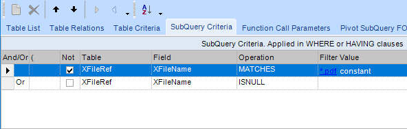

Great thanks brad, i was on the right track with the tables, i just tried adding the criteria to not show PDFs but unable to get the syntax correct at the moment.
Try a matches statement with *.PDF constant.
Brad
I can get *.pdf to show ok, but it would be nice to return jobs with out pdf attachments, i tired doing field name xfileref.xfilename compare operator ISNULL but doesn’t return anything even thou i have jobs with no pdf attachments.
Make sure the joins between the tables are Left Joins and set the Criteria on the SubQuery…
You can use the “Neg” checkbox on the criteria line item to return the opposite of the criteria match, I believe.

Do you want to see jobs that don’t have any attachments? This would be an outerjoin from the job Header to the Xfile table and then filter the display list.
Or are you trying to show job attachments that are not the .PDF extenstion? The previous email should do this for you.

Hi, i would like to filter on jobs with no pdf attachment but the null value doesn’t seems to be working.
