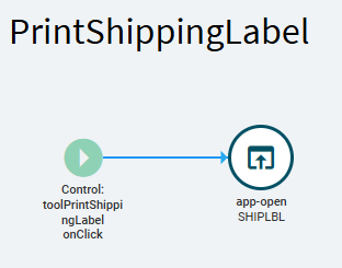

If they don’t come through natively in the uplift… you can try following the below, which I just commented on a different post the other day.

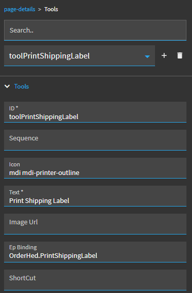

In your case, you’ll be adding a “print my report” tool… and then the app open event/widget will need to point to your (hopefully pre-existing) report MenuID or application:

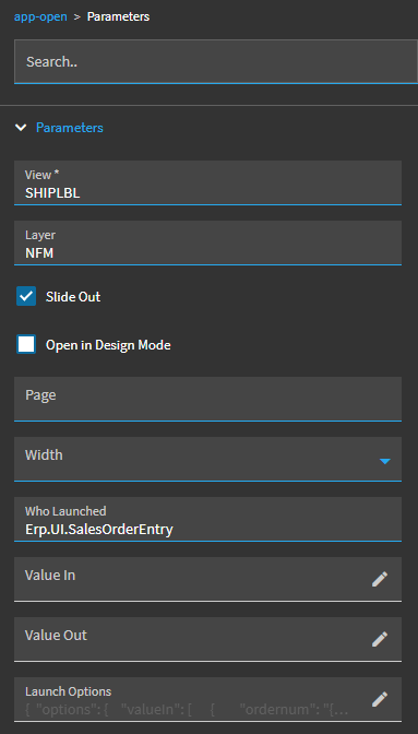

Below is an example of a “print report” tool i added to Order Entry:

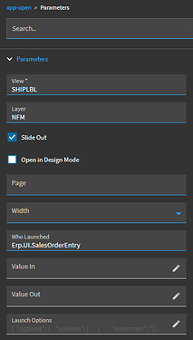

App-Open properties:
