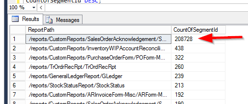

Here is a query to check the contributors of this table -
–Reports that are largest contributors to ReportServerTempDB size through tables Segment, ChunkSegmentMapping, SegmentedChunk and SessionData:

I think I see the culprit
Now what do I do about it?
You have to initiate the shrink of the log file after the backup. You can also safely truncate the SEGMENT table but take SSRS offline before doing this.
I would read the following link and it will help you clean up the data. Once that is cleaned up I would just monitor to see if something current is causing the size or perhaps it was during testing, etc.
