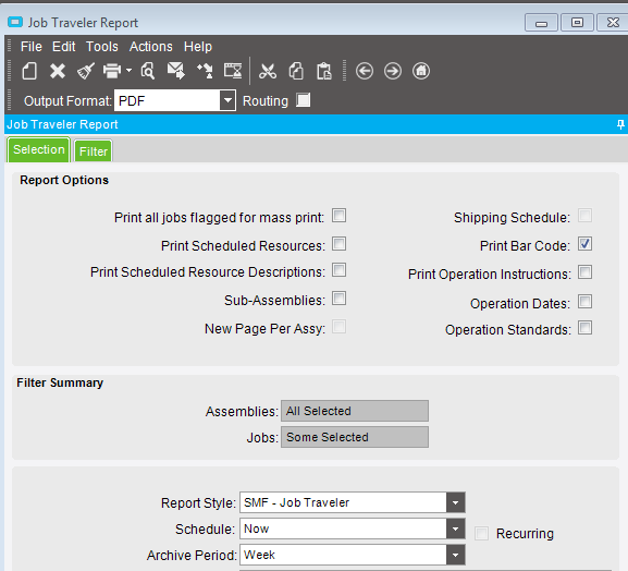

And even with an Archive period on None, you should be able to retrieve it from the system monitor, for about an hour.
