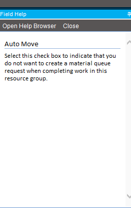

Might want to check “Auto Move” on the Resource Group.
The check box was checked for the resource. I unchecked it and ran a new job through and it still didn’t create one for job receipt to job. I don’t get how it works for stock jobs but not job to job.
