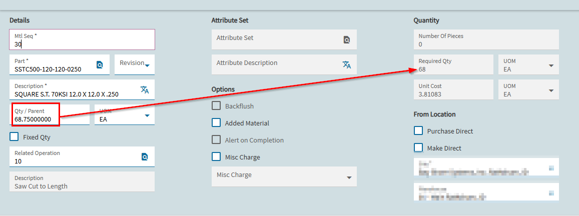

Anyone else have this issue? Quantity/Parent does not match required qty and seems to be treating it as an integer instead of a decimal. This is a HUGE problem since it will result in parts being cut to the wrong dimension that is too short to use.
Do you allow fractional Eaches? Most places don’t so this is kind of what I would expect TBH, it is rounding to a whole number, I’d expect it to be 69 though so in that case there might be an issue?
You allow decimals on EA?

@benjamin_graybill do you need to set your UOM on your part to a length?
YOU GUYS ROCK! Part was set up incorrectly! Thank you all! Don’t know how I didn’t catch that!
