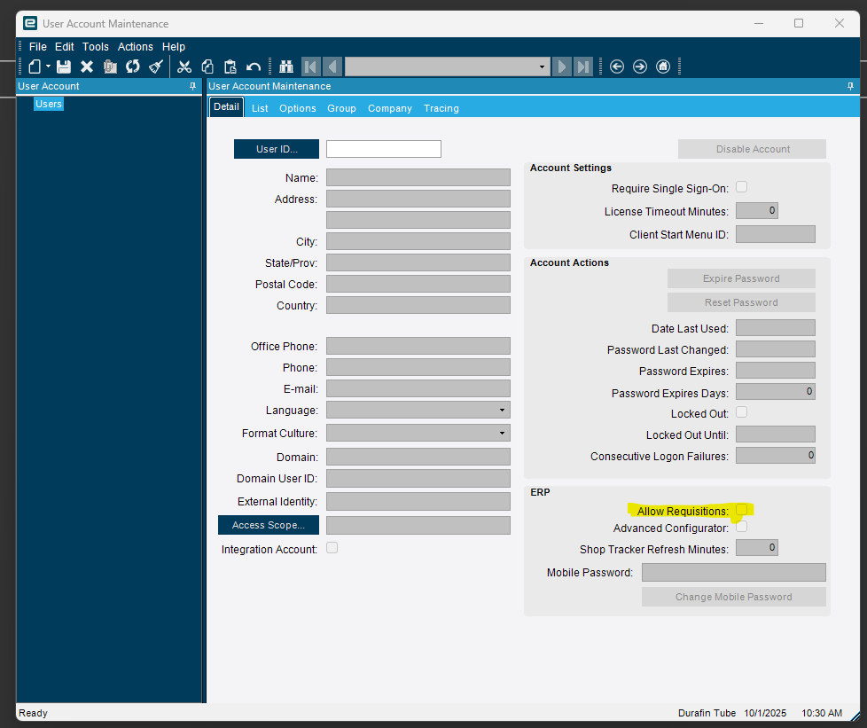

Trying to setup Requisitions in Kinetic, but my user can’t see Requisition Entry. I can see it. What are the security flags that define who can see this form? I think I turned on everything for the user, and it still won’t show him the form.
Yes. Funny, as a security manager I can access req entry even without that flagged. But my end user has this turned on and he still cant see req entry.
