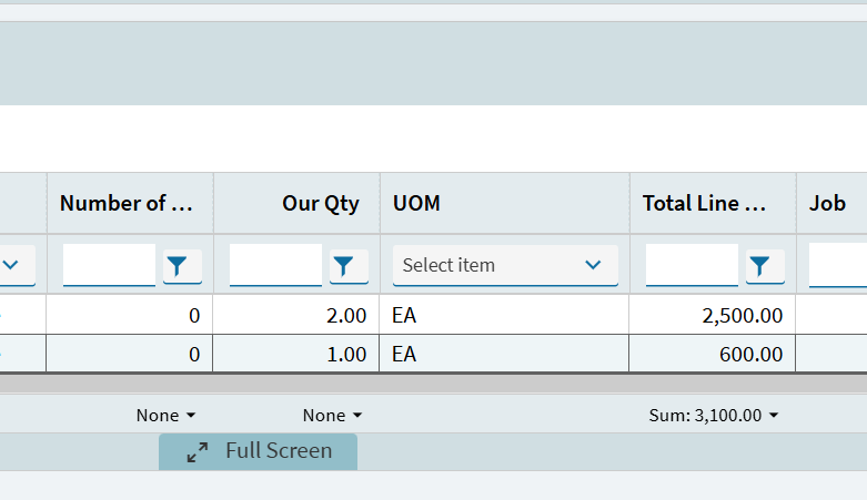

On the Install Admin dashboard there are a bunch of numeric columns, but probably only a couple that will be used often.
In this dashboard, I pulled the grid out from the panel card so we can collapse the grid in the layer and then expand it at run time.
When I got to the grid summaries, I had trouble setting the Show Summaries and having the footer appear.
I saw this earlier, where I tried clicking a few things before it worked and then I didn’t touch it again. :blush:
So, on this one, I collapsed the grid in the designer and expanded it again and the footers showed with “None” in the aggregate boxes in the footer.
I saved that, and it didn’t stick when published.
I set one of the numeric columns to Sum to see if it would make the footer show. It did, but then only the column I set to Sum had anything in the aggregate selection boxes (unable to turn on the rest). And going back into the layer, the designer had the same problem. And I couldn’t make it go away.
Luckily, I saved a copy just before starting the summaries.
I loaded the copy, collapsed and expanded the grid, set all the numeric columns that might ever be used to Sum. That worked when published.
Then I went back and set most of the numeric columns back to None and saved again. That seemed to work as well, so the two columns most likely to sum are set to Sum and the rest are set to None, but can be set by the user.
I learned to be sure to collapse the grid again after making changes, by the way.

I’ve added a Column to the grid mapped to DocExtCost. Seems to work slightly better than using the base “DocExtCost” column and I was able to give it a user friendly heading:
