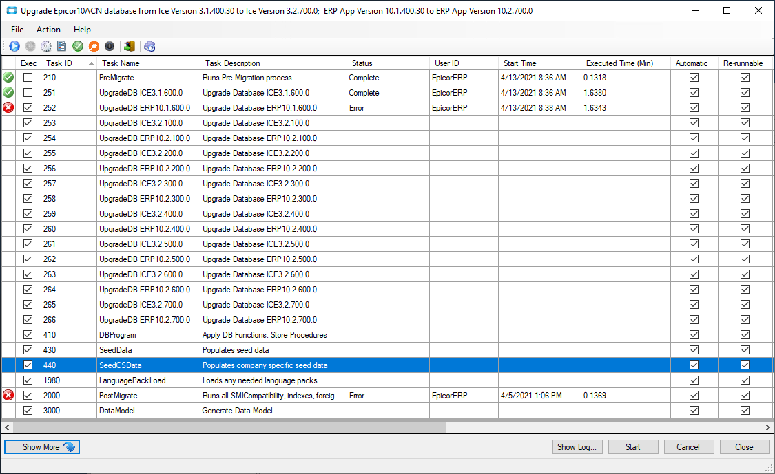

Reset Database Upgrade Utility 'Task List'
Is it possible to refresh/reset the list of tasks in the Database Upgrade utility? It is pulling in a list (with error/completion history) from a past failed upgrade. I want it to completely re-evaluate the database and rebuild that task list but I can’t find a way to do it.
Thank you
There is an XML file that stores this information in the following folder:
C:\Program Files (x86)\Common Files\Epicor Software\Database Manager Extensions\3.2.700\DB Migration\MigrationTasks
Deleting the appropriate file for the database I am upgrading forced the tool to regenerate the list.
