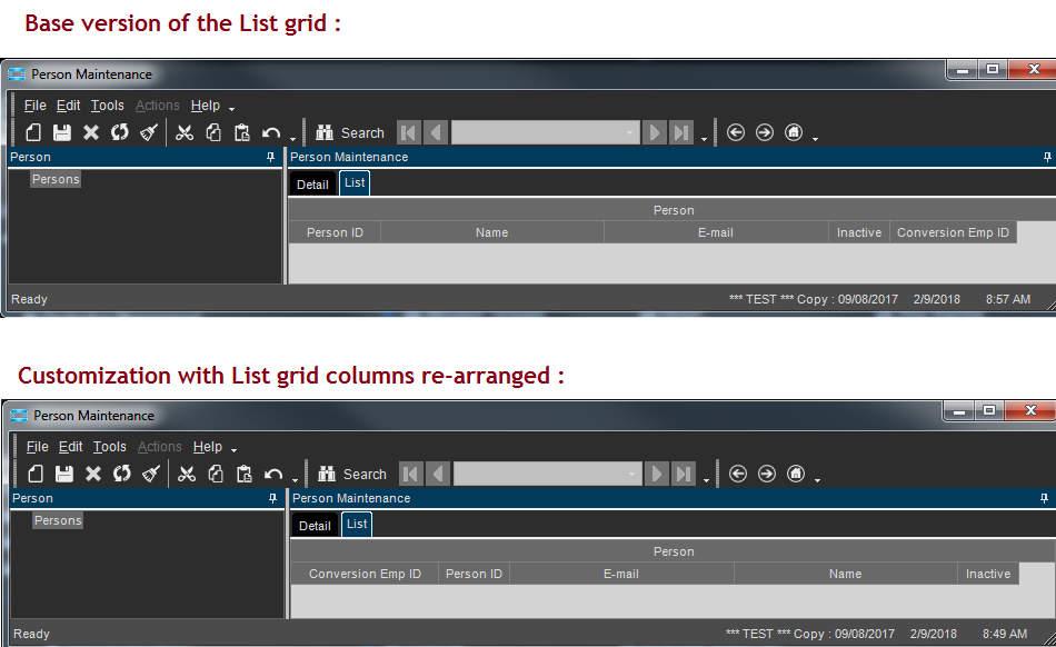

I made a copy of the Customization from Production Mgmt => Job Mgmt => Setup => Person. Then I moved around the columns in the List tab and did the Tools => Save Layouts.

That said, when you think you have the correct Layout section for the grid you want to revert to Base column order, delete that section as in the screenshot :
Delete all the section lines highlighted with the yellow vertical line, and only those lines.
Save the Customization .Xml and then import that Customization into Epicor.
When you open that Customization, the grid column order should be back to the Base order.
