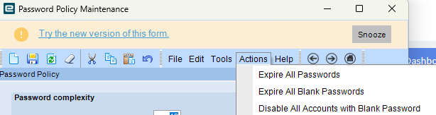

Heads up note for the record.
Under Password Policy Maintenance / Actions Tab
Additional tools:

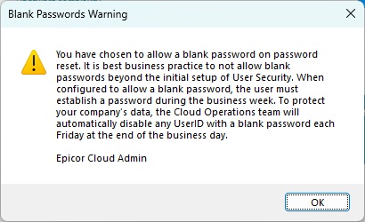

I have not directly proven this myself, but have been told by Cloud Support that any blank passwords on Cloud environments are expired on a weekly basis. I DO have the experience of having a user tell me that the blank password I set up for them previously doesn’t work any more, and I’ve had to reset it for them, but I don’t know what their “schedule” is for the auto-expiration.
Friday’s from what I recall the documentation saying.
Edit: Add screenshot
BlankPW
I didn’t even know that was an option. I thought that feature was completely disabled in cloud. It should be.
In the cloud, the account locks overnight if you don’t set the password to something other than blank.
