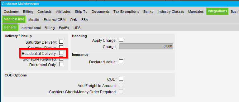

Epicor has a check box on both the customer and the shipto to indicate the address as a Residential delivery. You can use that and query it. It is under Manifest info->General
@bderuvo Bryan - Thanks. I was hoping there was something out of the box that just works. Good to know that is there if we need to develop a connection to the API.

@Vinaykamboj - I think this field is manually entered. We’re looking to mistake proof it and have it be automatic. Back up plan (if we can’t automate it) is to have a pop-up at Customer Entry & Order Entry to prompt our salespeople to ask the customer…
