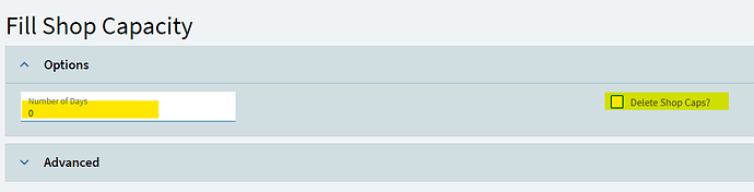

I think I’ve discovered an issue with the ‘Generate Shop Capacity’ process. I schedule this to run weekly, with ‘Number of Days’ set to 365, to generate capacity data for the next year.
Importantly, I leave ‘Delete Shop Caps?’ unticked, because I do not want it to delete existing/historical data.
