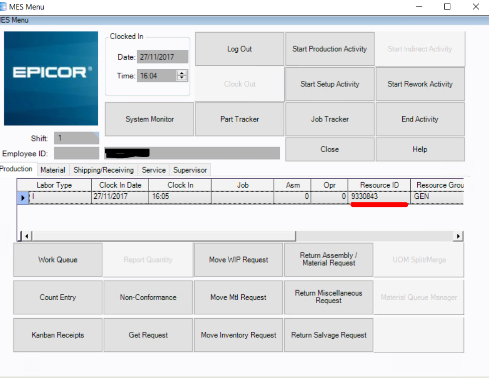

Open TEST EPICOR MES.
Log in and confirm shift ID.
Click “start indirect activity”.

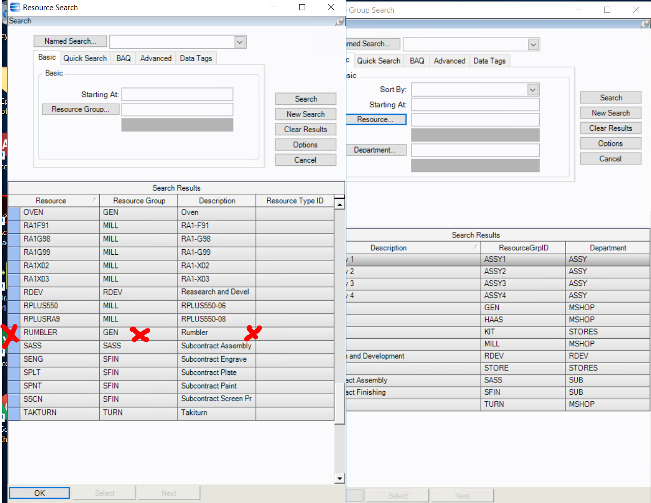

Select an INDIRECT CODE.
Select a Resource Group ID (in here you can search the resources (machines) )…But, as per the reason i put this help request in, i selected the GEN resource group but the ResourceGroupID (machine) of “rumbler” is not actually selected in the main screen…its picked a different one (underlined in red).
