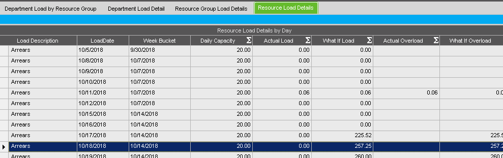

The resource group shop load graph is showing Arrears What If hours that I cannot find with a Job Oper BAQ.
We have regenerated the Shop Load Graph process set.
Any ideas?
