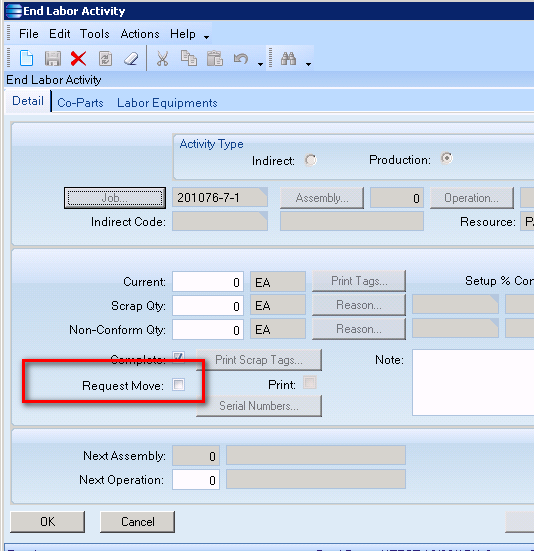

Rachel,
I think you have to request this move on the end activity screen.

Hi Brad,
Yes, I have been checking that box upon reporting any quantity. Thank you!
