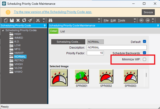

Hello ZanebK,
Did you find a solution for moving a single job operation ( using move option “operation only” and override material constraints and finite unchecked ). We recently migrated to Kinetic 2023.2 and when applying the mentioned options all job operations move to a different date/time in job/resource scheduling board instead of the selected/moved operation only …
( in Epicor 10 we could easily move a single job operation wihout moving the other job operations ( preceding or subsequent ) )
Appreciate any feedback !
I’m looking for advice on the same issue. When selecting “Move Operation” it seems to move all operations for that particular job, rather than just the one selected. Could anyone provide guidance on this please?
Hi Robert,
We solved the issue in Kinetic 2023.2 by unchecking “Minimize WIP” in “Scheduling Priority Code Maintenance”
Hi Dick,
Thats brilliant, thank you. ill give that a whirl…
