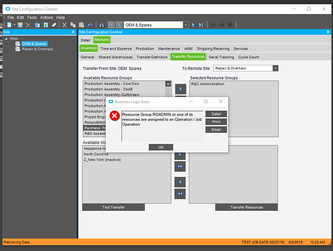

So we are creating a second plant and I have already transfered my warehouses to the new plant but when I try to transfer the resources I get an error that it is assigned to an Opersation /Job Operation.
Is there way around this?? How do I move these resources to the new plant?
We’re having a similar issue. In E9 when we split one of our “Warehouses” into its own Site, we successfully transferred Resources to new Groups in the new Site. However in E10, we’re trying to move some Resources to a different Site since those production lines have moved and are running into a similar error you got, even though all existing jobs have been closed.
I have a support ticket open (CS0001638321), and the support rep is researching this with Development to see if this behavior changed between E9 and E10.2.300.15 (our current version). I’m thinking the logic changed from “Are any jobs open that use this Resource/Resource Group?” to “Are there any jobs at all that use this Resource/Resource Group?”. I’m hoping it’s a bug and we’ll still be able to transfer the Resources.

You will need to change the resources on ALL jobs (including closed jobs) to move the resources. My case from 2019 was CS0001638321 and the feedback from development was that this was an intended change to block moving a resource to another site after it’s been used in any of these tables:
• ShopLoad
• ResourceTimeUsed (Resource was scheduled)
• JobOpDtl (Scheduled resource of job operation in Job Entry)
• OpMasDtl (Scheduled resource of operation in Operation Entry)
