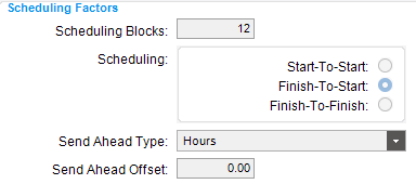

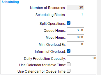

What are the values on the Resource Group for Scheduling Blocks and Split Operations? Same question for that Operation on the BOO, what value is in the Scheduling Blocks?
Ok. Not 100% sure, but my guess is that it has to do with the Split Operations flag and the Scheduling Blocks. From Help:
Used for scheduling. If YES then a single operation in this Resoure Group can be split across multiple Resources.
Number of Resources that one operation runs on at a time within this Resource Group. This affects how much of the total daily Resource Group capacity is used up per operation. If Resource Group has 4 Resource, 8 hour a day, and SchMachine = 2. An operation will schedule up to 16 hours per day. This is used as a default to the JobOper.Machines field.
I know you said that you do not use scheduling, but scheduling parameters are considered for costing. When you have an operation that has an RG and R as the scheduling resources, it will calculate the cost based off of the R, not the RG. So, in this instance, it calculated the Labor and Burden using only 1 R in the RG. When you removed the R, it calculates the Labor and Burden across all resources since you have Split Operations as True and Scheduling Blocks as 1. My theory is that you told the system it could split the operation over multiple resources but the operation can only run on one resource per the Scheduling Blocks. So I think it is calculating the estimate off of multiplying the estimated setup and labor by 20 instead of 1.
This is just a guess. I would set the Scheduling Blocks to 20 and see what the estimate does. Then I would set it back to 1 and turn off the Split Operations and see what the estimate is.
