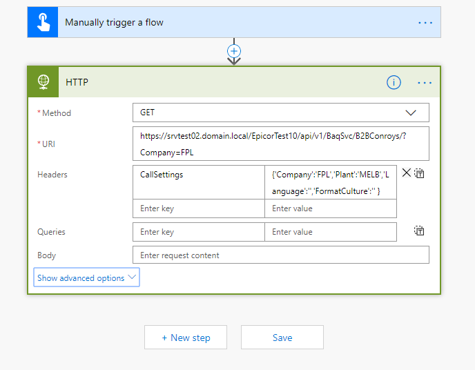

Am looking at 365 Flow as a simple test bed for REST but am unable to connect to our Test server. We have set up a Gateway on the server but are unable to Connect to the Server. I try and do a simple Flow
. I am getting error message ā€œThe provided host name ā€˜srvtest02.domain.local’ could not be resolved.ā€ Our setup is incorrect somehow.If I use Postman data comes back OK.

Not sure if you should be using anything external without fully understanding DNS and how Web Servers talk to each other :slight_smile:
I would assume that srvtest02.domain.local is not known to anyone but your local network… DNS 101 you are going to need to specify your external domain/ip, something that you could access outside of the network via your mobile phone on 3G Connection via a browser for example.
You would need to setup an external domain, make sure that 443 the SSL Port can be accessed from the outside by adding an exception in your firewall, among other things.
If you were Office 365 located in England and you did ping srvtest02.domain.local it would yield… nothing. Hence the
The reason it works via POSTMAN is… because its running on your PC connected to the network with awareness of the srvtest02.domain.local

Because you are using the on-premise gateway it does not rely on any public DNS and is more like a VPN tunnel that will pass the same URL you use in Postman locally. In the flow admin did you create a custom connector using this gateway? I am trying to find 10 minutes today and I will publish a quick example.
Here is a quick guide on how to configure the Microsoft Flow gateway, the custom connector for Epicor REST, and test an action against it.FLOW_Setup-OnPrem-Connector.pdf (485.0 KB)
