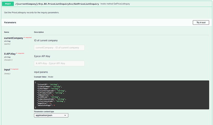

How about PriceListInquirySvc instead?

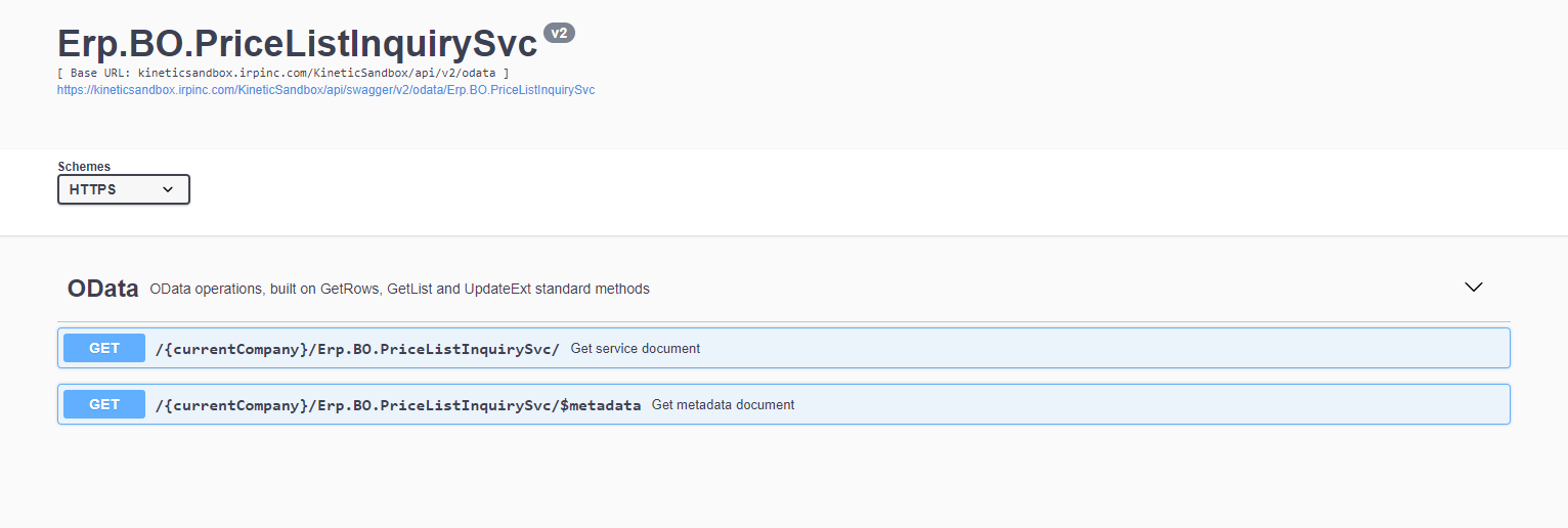

@ckoch after running a few more traces, I was zeroing in on PriceListInquirySvc, but when I look at v2 help for this service in 2021.1, the post method you screen shot isn’t listed. Hmmm…

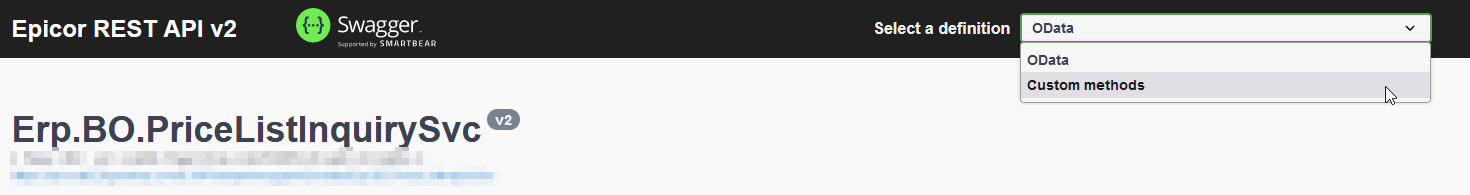

In the top-right corner you’ll need to choose “Custom Methods”. This is where all the methods that you’ll find in your trace logs will be, for just about every Epicor service.
Thanks! Very useful tip. Hadn’t encountered that one before.
