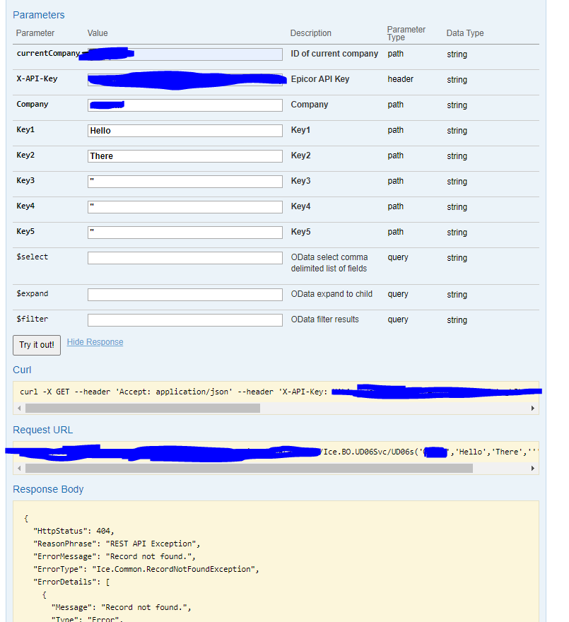

It seems that all user defined tables come with five “keys” that you must use. My resource really only has one field that could logically be a key so I have been leaving the rest empty (as in an empty string). However, I noticed that these fields are “required” in the Swagger interface and there seems to be no way to enter an empty string and I can’t send the request. This seems like a common use case where Swagger (which has been an exceptional tool) can’t function as expected.
This all works fine over Postman where I can easily use ‘’ as empty string in the URL and ultimately I will be able to deal with it in my application code so this isn’t a show stopper.

I just checked and you’re right. It looks like the Swagger page is adding the apostrophes to the input strings automatically, but the Swagger UI is requiring you type something into those fields. I wonder if this is a bug with how Epicor set up the Swagger page or with Swagger itself.
For what it’s worth, I use empty Key2,3,4,5 fields in the UD tables all the time. There’s no (supported) way to remove them.
