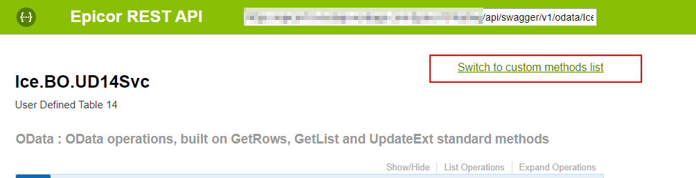

Use the custom methods and post the where clause that way maybe?
Thanks for responding @jgiese.wci
Would you mind explaining what you mean by “custom methods”. Is that an Epicor thing or and OData/REST thing?
edit: or a BAQ? I’ve never done that (more developer than Epicor user)
Those are viewable in swagger. They basically give you access via REST directly to the BO method. Be warned when you go to the custom methods pages (especially for partsvc) it will take a long long time to load. Just wait it out.
