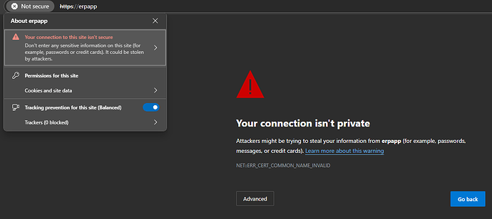

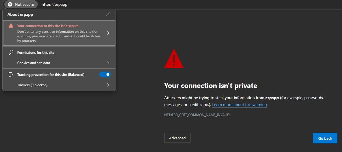

What happens if you just go to:
https://tpa1-eas01.domain.com in a browser? Do you get a certificate error like this?

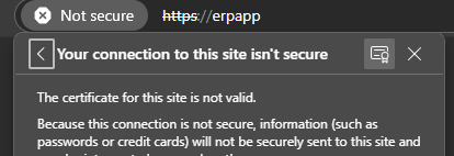

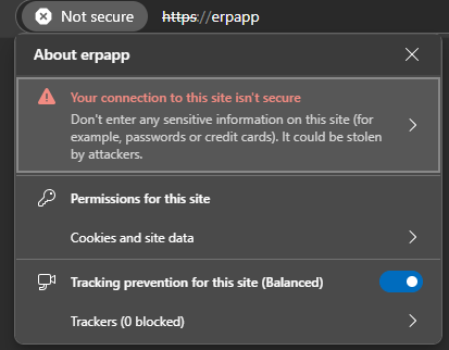

If you click on the Not Secure (assuming Edge, but Chrome has something similar)
and then the “Your connection to this site isn’t secure” line, you will see this:

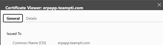

Click on the little certificate icon in the upper-right hand side:
Does the Common Name (CN) match what you are entering in the URL and Postman?

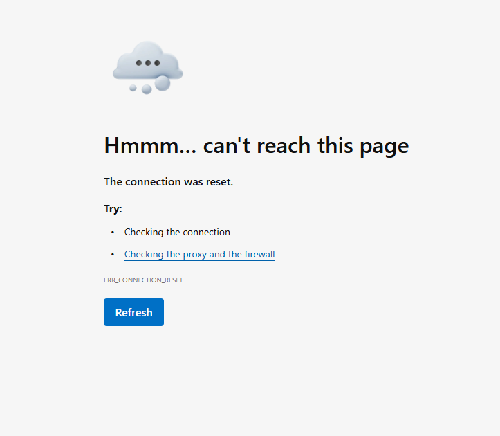

We tried rebooting with no change. I have tried the domain URL but I still get the connection reset error:
