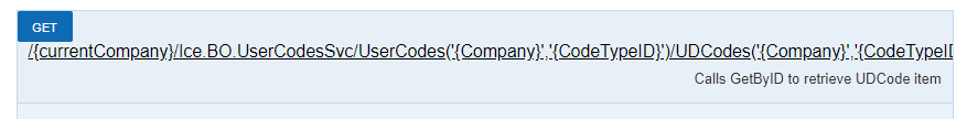

9
I know but I figured since its just OData there was nothing for Epicor to do on their part… OData is OData… but apparently they parse the $commands
If you are looking for a single Item I guess you could use this.
