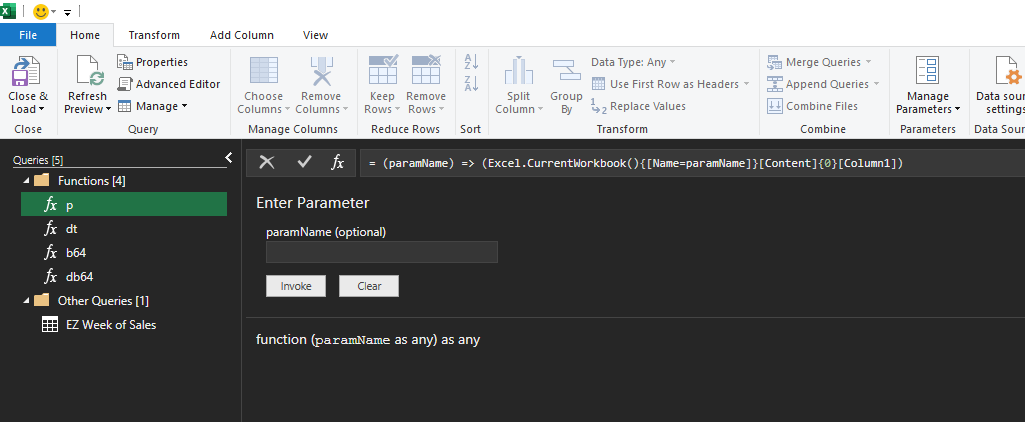

Try this:
// p function
let
    Source = (paramName) => (Excel.CurrentWorkbook(){[Name=paramName]}[Content]{0}[Column1])
in
    Source
// ODataCall Info

EDIT: Forgot to say you should have 2 named cells, WeekStartDate and WeekEndDate where you enter parameters. The p() function will grab them from your worksheet.

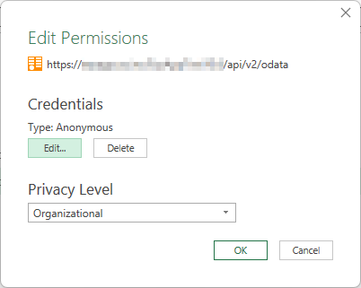

Global permissions: {Anonymous}
https ://server/Instance/api/v2/odata
This should be sufficient to get it working.

  1. The data source had to be OData feed, anonymous.
  2. I think that pointing the permissions to https ://server/Instance/api/v2/odata was also important.
Initially this didn’t work, but I “Close & Loaded”, and it seems to have connected properly! Awesome!

You can also start with simple blank query {or even Other Sources > Web} and you will get the appropriate popups for OData feed security connection type unless you have set them already. You can always adjust using the Data Source settings in the Power Query Editor ribbon. Just select the Global permissions radio button.
