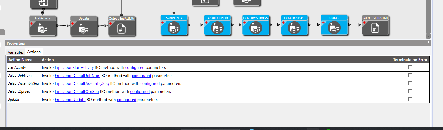

To test I manually clocked in to a job from MES, did call to GET GetActiveLaborDtl and copied that JSON into my POST “Start Activity”. I changed a few fields like clock in time.

Hi Christian,
Are you calling Labor.Update after your call to StartActivity?
Here’s the set of BO methods I call as part of an Epicor function that starts activity:
I found that I didn’t need to make any changes to RowMod to get this to work.
Many thanks,
Nathan
Hi, these are the business objects i am calling to create the labour, I think you need to run the update after the start activity.
Erp.BO.EmpBasicSvc/ClockIn
Erp.BO.LaborSvc/GetByID
Erp.BO.LaborSvc/StartActivity
Erp.BO.LaborSvc/DefaultJobNum
Erp.BO.LaborSvc/LaborRateCalc
Erp.BO.LaborSvc/DefaultOprSeq
Erp.BO.LaborSvc/CheckWarnings
Erp.BO.LaborSvc/CheckEmployeeActivity
Erp.BO.LaborSvc/CheckFirstArticleWarning
Erp.BO.LaborSvc/Update
Then to finish and complete the job we call
Erp.BO.LaborSvc/GetDetail
Erp.BO.LaborSvc/EndActivity
Erp.BO.LaborSvc/EndActivityComplete
