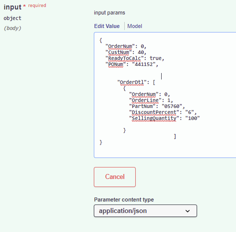

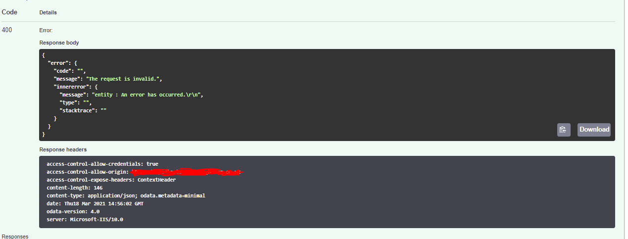

I can Post a Sales Order through REST v1 perfectly fine. but i am really struggling with v2.
I have attached the ‘input’ and the ‘response’
the API key seems to be working ok as if i remove it, it asks for a valid API Key.
What is the type of DiscountPercent and SellingQuantity? maybe try to remove quotes around them?
They are decimal. I did try your suggestion but the issue persists.
I was going to suggest the same as Olga, no idea why it doesn’t work. I tried below and it does.
Replace company/customer and give it a try.

no, the error means it is something wrrong with data you send. Is there anything in server Event Viewer for app server?

Base on the difference between Jonathan’s example and yours, try replacing OrderDtl with OrderDtls. Thats the only other difference I can see.
Nice catch, hopefully that is it.
