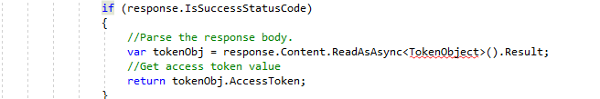

a little stuck obtaining the token, getting this error:
(code from the rest services documentation obtaining a token)
Type or Namespace TokenObject could not be found
A quick search online did not help

@spaceage Chris, did you implement this, I’m struggling with the “TokenObject” in the ReadAsAsync call when obtaining token (see above), thx
I did not, sorry Scott.
in the code “ReadAsAsync<TokenObject>()”, TokenObject is a type which you must define as a class.

Consequently, your class needs to be something like:
public class TokenObject
public string AccessToken { get; set; }
public int ExpiresIn { get; set; }
public string TokenType { get; set; }
Then the command ReadAsAsync will know how to process it and
tokenObj.AccessToken will resolve correctly
