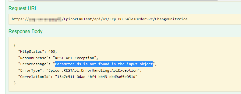

It’s not updating in the code as I get “Parameter ds is not found in the input object”
I’ve exported the response data - checked it’s a valid JSON - the file is only 770kb which shouldn’t be an issue.

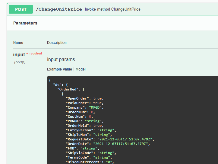

When I run this in Swagger it looks the same as the sample:
however this is what it is showimg me:
